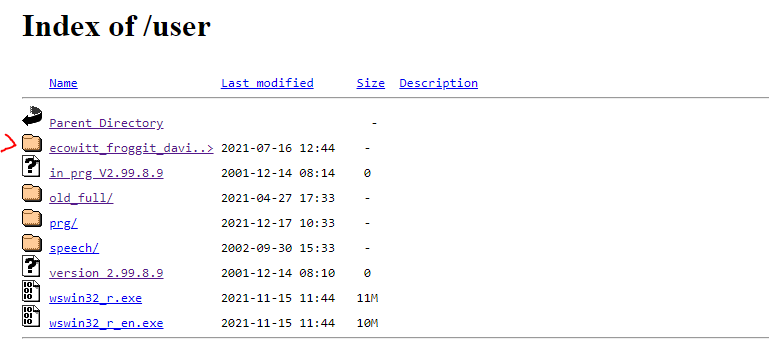

Guten Tag,
ich bin neu hier und stehe gerade etwas auf dem Schlauch, ich besitze eine Davis VP2 + Weatherlink live 6100. Wo genau finde ich "/user/ecowitt_froggit_davislive_airlink/davislive_airlink_windows_64-bit" ?
Ich bedanke mich im Voraus für Ihre Hilfe.
LG
Patrick
- Jürgen B
- Beiträge: 68
- Hat sich bedankt: 6 mal
Re: Weatherlink Live oder Airlink jetzt auch unter Windows ohne Webserver nutzbar
das findest Du im Userbereich von WsWin
dort musst Du dich mit deinen Zugangsdaten
anmelden.
anmelden.
Schöne Grüße Jürgen

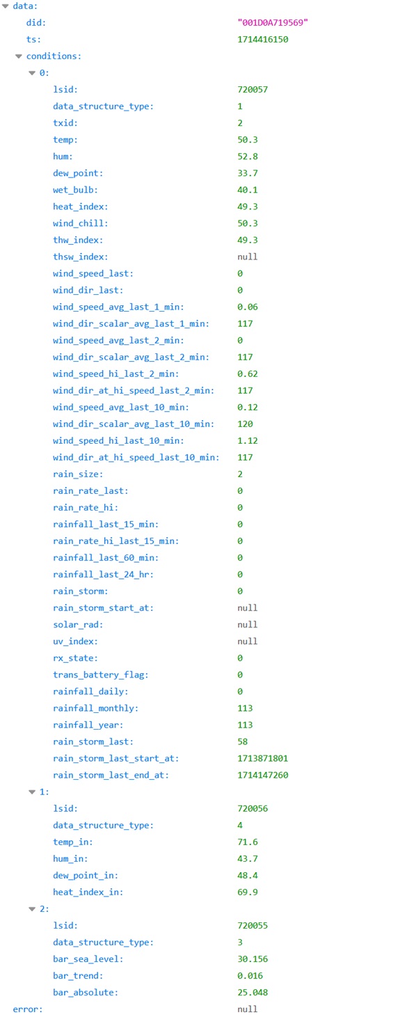

Hier mal die Ausgabe von http://192.168.1.147/v1/current_conditions:
{"data":{"did":"001D0A719923","ts":1717140150,"conditions":[{"lsid":734418,"data_structure_type":1,"txid":1,"temp": 61.1,"hum":93.6,"dew_point": 59.2,"wet_bulb": 59.9,"heat_index": 62.0,"wind_chill": 61.1,"thw_index": 62.0,"thsw_index":null,"wind_speed_last":2.00,"wind_dir_last":47,"wind_speed_avg_last_1_min":3.06,"wind_dir_scalar_avg_last_1_min":53,"wind_speed_avg_last_2_min":2.93,"wind_dir_scalar_avg_last_2_min":42,"wind_speed_hi_last_2_min":8.00,"wind_dir_at_hi_speed_last_2_min":63,"wind_speed_avg_last_10_min":2.87,"wind_dir_scalar_avg_last_10_min":43,"wind_speed_hi_last_10_min":8.00,"wind_dir_at_hi_speed_last_10_min":63,"rain_size":2,"rain_rate_last":0,"rain_rate_hi":0,"rainfall_last_15_min":0,"rain_rate_hi_last_15_min":0,"rainfall_last_60_min":0,"rainfall_last_24_hr":82,"rain_storm":82,"rain_storm_start_at":1717108080,"solar_rad":null,"uv_index":null,"rx_state":0,"trans_battery_flag":0,"rainfall_daily":82,"rainfall_monthly":82,"rainfall_year":82,"rain_storm_last":null,"rain_storm_last_start_at":null,"rain_storm_last_end_at":null},{"lsid":734419,"data_structure_type":2,"txid":2,"temp_1": 61.6,"temp_2": 61.0,"temp_3": 60.7,"temp_4": 59.7,"moist_soil_1":null,"moist_soil_2":5.9,"moist_soil_3":null,"moist_soil_4":6.8,"wet_leaf_1":null,"wet_leaf_2":null,"rx_state":0,"trans_battery_flag":0},{"lsid":734420,"data_structure_type":1,"txid":4,"temp":null,"hum":null,"dew_point":null,"wet_bulb":null,"heat_index":null,"wind_chill":null,"thw_index":null,"thsw_index":null,"wind_speed_last":null,"wind_dir_last":null,"wind_speed_avg_last_1_min":null,"wind_dir_scalar_avg_last_1_min":null,"wind_speed_avg_last_2_min":null,"wind_dir_scalar_avg_last_2_min":null,"wind_speed_hi_last_2_min":null,"wind_dir_at_hi_speed_last_2_min":null,"wind_speed_avg_last_10_min":null,"wind_dir_scalar_avg_last_10_min":null,"wind_speed_hi_last_10_min":null,"wind_dir_at_hi_speed_last_10_min":null,"rain_size":1,"rain_rate_last":0,"rain_rate_hi":0,"rainfall_last_15_min":0,"rain_rate_hi_last_15_min":0,"rainfall_last_60_min":0,"rainfall_last_24_hr":0,"rain_storm":null,"rain_storm_start_at":null,"solar_rad":98,"uv_index":0.0,"rx_state":0,"trans_battery_flag":0,"rainfall_daily":0,"rainfall_monthly":0,"rainfall_year":0,"rain_storm_last":null,"rain_storm_last_start_at":null,"rain_storm_last_end_at":null},{"lsid":734417,"data_structure_type":4,"temp_in": 73.2,"hum_in":56.4,"dew_point_in": 56.8,"heat_index_in": 73.1},{"lsid":734416,"data_structure_type":3,"bar_sea_level":29.774,"bar_trend": 0.027,"bar_absolute":29.727}]},"error":null}
Hier wird im ersten Block wohl die ISS dargestellt und im zweiten Block die beiden Stationen (SoilMoist, UV und Solar) vom Transmitter mit der ID4. Soweit sind wohl also alle Daten vorhanden, werden nur vom Script nicht alle ausgelesen.

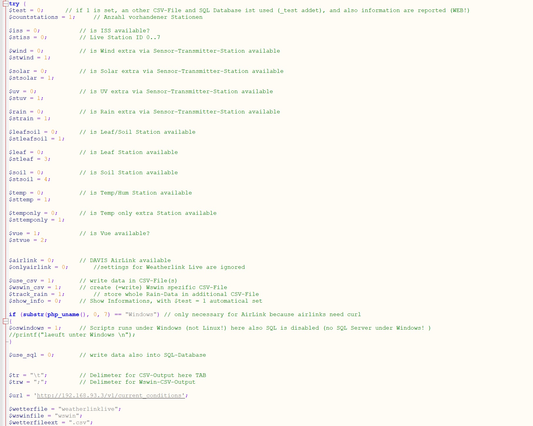

try {
$test = 0; // if 1 is set, an other CSV-File and SQL Database ist used (_test addet), and also information are reported (WEB!)
$countstations = 1; // Anzahl vorhandener Stationen
$iss = 1; // is ISS available?
$stiss = 0; // Live Station ID 0..7
$wind = 0; // is Wind extra via Sensor-Transmitter-Station available
$stwind = 0;
$solar = 1; // is Solar extra via Sensor-Transmitter-Station available
$stsolar = 2;
$uv = 1; // is UV extra via Sensor-Transmitter-Station available
$stuv = 2;
$rain = 0; // is Rain extra via Sensor-Transmitter-Station available
$strain = 1;
$leafsoil = 0; // is Leaf/Soil Station available
$stleafsoil = 1;
$leaf = 0; // is Leaf Station available
$stleaf = 3;
$soil = 1; // is Soil Station available
$stsoil = 1;
$temp = 0; // is Temp/Hum Station available
$sttemp = 1;
$temponly = 0; // is Temp only extra Station available
$sttemponly = 1;
$vue = 0; // is Vue available?
$stvue = 2;
$airlink = 0; // DAVIS AirLink available
$onlyairlink = 0; //settings for Weatherlink Live are ignored
$use_csv = 1; // write data in CSV-File(s)
$wswin_csv = 1; // create (=write) Wswin spezific CSV-File
$track_rain = 1; // store whole Rain-Data in additional CSV-File
Hier ein Auszug aus meiner Wetterstation.php:
try {
$stwind = 0;
$stsolar = 2;
$stuv = 2;
$strain = 1;
$stleafsoil = 1;
$stleaf = 3;
$stsoil = 1;
$sttemp = 1;
$sttemponly = 1;
$stvue = 2;
$show_info = 0; // Show Informations, with $test = 1 automatical set
if (substr(php_uname(), 0, 7) == "Windows") // only necessary for AirLink because airlinks need curl
$oswindows = 1; // Scripts runs under Windows (not Linux!) here also SQL is disabled (no SQL Server under Windows! )
//printf("laeuft unter Windows \n");
$use_sql = 0; // write data also into SQL-Database
$tr = "\t"; // Delimeter for CSV-Output here TAB
$trw = ";"; // Delimeter for Wswin-CSV-Output
$url = 'http://192.168.1.147/v1/current_conditions';
THSW wird wohl nicht berechnet, weil Solar und UV ja erst im zweiten Block auftauchen, leider kann man die wohl nicht (wie beim Wind) per Einstellung in der WLL-App in den ISS-Block integrieren lassen..
Ist es irgendwie möglich, das Script anzupassen, dass alles ausgegeben wird? Ich muss dazu sagen, das ich keine Ahnung von PHP-Programmierung habe..
Ich habe ja auch noch eine MeteoBridge über die WLL laufen, ist es hier vielleicht einfacher, ein passendes WSWIN-Export-Script zu nutzen?
Vielen Dank für deine Hilfe und Zeit!
Beste Grüsse
Michael

- Beiträge: 6154
Du hast keine 4 Stationen!
Du stellst aber mit $uv = 1
eine 4.Station ein und damit werden die Innendaten und Luftdruck nicht mehr gefunden.
"data_structure_type":1,"txid":1, -> ISS --> 0
"data_structure_type":2,"txid":2, ->Soil --> 1
"data_structure_type":1,"txid":4, ->Solar und UV --> 2
Du hast aber Recht mit
$stsolar = 2;
Das war von mir falsch!
$stsolar = 2;
