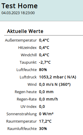

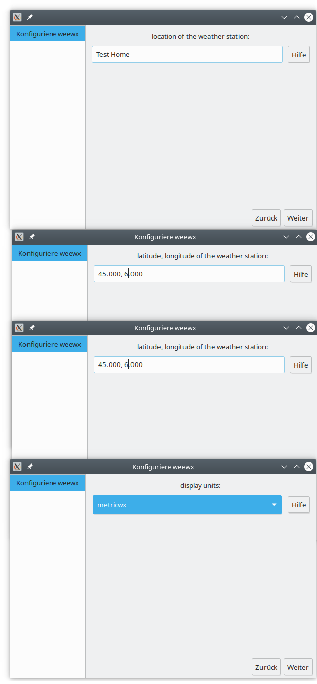

Auf dem lokalen PC habe ich weewx NEU installiert und entsprechende Einträge bzgl. Einheiten in der weewx.conf vorgenommen
In der HTML Seite erscheint mbar.
Habe ich etwas falsch gemacht? oder ist es ein BUG?

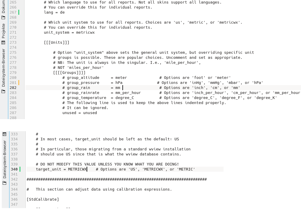

Diese Einträge in der weewx.conf unter [[[[Groups]]]]
sind zwingend notwendig, sonst wird mbar bzw. m/s angezeigt.
[StdReport]
    [[Defaults]]
        [[[Units]]]
            [[[[Groups]]]]
                  group_pressure = hPa                # Options are 'inHg', 'mmHg', 'mbar', or 'hPa'
                  group_speed = km_per_hour    # Options are 'mile_per_hour', 'km_per_hour', 'knot', or 'meter_per_second'
                  group_speed2 = km_per_hour2    # Options are 'mile_per_hour2', 'km_per_hour2', 'knot2', or 'meter_per_second2'

Unter GROUPS habe ich die Zeilen der lokalen Installation von weewx.conf in die DAV.CONF (vom Raspi4) kopiert und die seit Jahren vorhandenen Einträge ALLE auskommentiert.
            [[[[Groups]]]]
                 group_altitude     = meter              # Options are 'foot' or 'meter'
                 group_rain         = mm                 # Options are 'inch', 'cm', or 'mm'
                 group_rainrate     = mm_per_hour        # Options are 'inch_per_hour', 'cm_per_hour', or 'mm_per_hour'
                 group_temperature  = degree_C           # Options are 'degree_C', 'degree_F', or 'degree_K'
                # The following line is used to keep the above lines indented properly.
                # It can be ignored.
                unused = unused
#                group_altitude = meter    # Options are 'foot' or 'meter'
#                group_degree_day = degree_C_day    # Options are 'degree_F_day' or 'degree_C_day'
#                group_distance = km    # Options are 'mile' or 'km'
#                group_pressure = hPa    # Options are 'inHg', 'mmHg', 'mbar', 'hPa', or 'kPa'
#                group_rain = mm    # Options are 'inch', 'cm', or 'mm'
#                group_rainrate = mm_per_hour    # Options are 'inch_per_hour', 'cm_per_hour', or 'mm_per_hour'
#                group_speed = km_per_hour    # Options are 'mile_per_hour', 'km_per_hour', 'knot', or 'meter_per_second'
#                group_speed2 = km_per_hour2    # Options are 'mile_per_hour2', 'km_per_hour2', 'knot2', or 'meter_per_second2'
#                group_temperature = degree_C    # Options are 'degree_F' or 'degree_C'
Nun stimmen auch hier die EINHEITEN.
