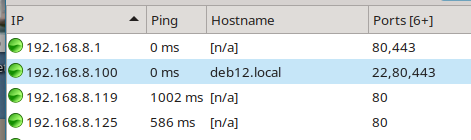

└─ $ ▶ ping 192.168.8.125
PING 192.168.8.125 (192.168.8.125) 56(84) bytes of data.
64 bytes from 192.168.8.125: icmp_seq=1 ttl=255 time=4306 ms
64 bytes from 192.168.8.125: icmp_seq=2 ttl=255 time=3306 ms
64 bytes from 192.168.8.125: icmp_seq=3 ttl=255 time=2305 ms
64 bytes from 192.168.8.125: icmp_seq=4 ttl=255 time=1603 ms
64 bytes from 192.168.8.125: icmp_seq=5 ttl=255 time=603 ms
Kann der Airlink-Sensor überhaupt sterben?
