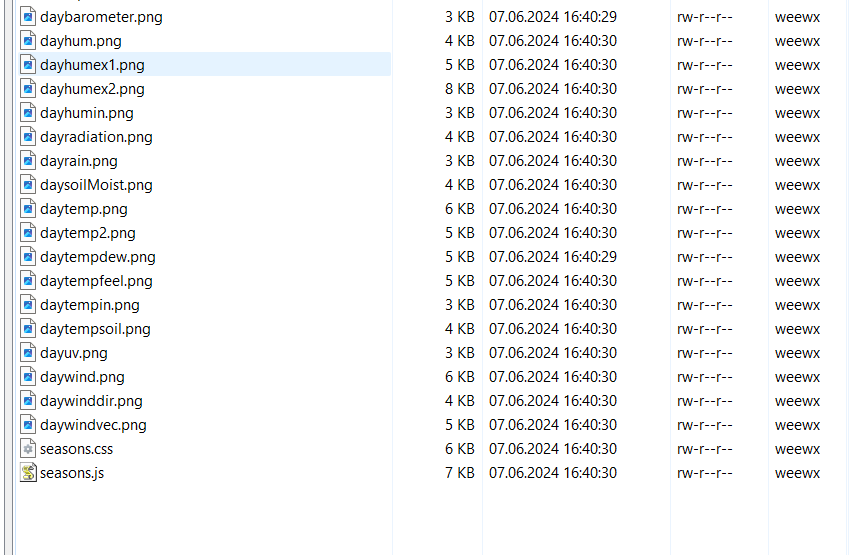

Hab auf Deiner Seite einen Link gefunden.
Diese Dateien habe ich in /etc/weews/skins/Seasons ausgetauscht.
Leider werden nur ein paar Dateien erstellt:
Und viele Fehlermeldungen:

Jun 07 16:40:29 raspberrypi weewxd[9982]:   File "/usr/share/weewx/weewx/cheetahgenerator.py", line 194, in init_extensions
Jun 07 16:40:29 raspberrypi weewxd[9982]:     klass = weeutil.weeutil.get_object(x)
Jun 07 16:40:29 raspberrypi weewxd[9982]:             ^^^^^^^^^^^^^^^^^^^^^^^^^^^^^
Jun 07 16:40:29 raspberrypi weewxd[9982]:   File "/usr/share/weewx/weeutil/weeutil.py", line 1404, in get_object
Jun 07 16:40:29 raspberrypi weewxd[9982]:     module = importlib.import_module(module_name)
Jun 07 16:40:29 raspberrypi weewxd[9982]:              ^^^^^^^^^^^^^^^^^^^^^^^^^^^^^^^^^^^^
Jun 07 16:40:29 raspberrypi weewxd[9982]:   File "/usr/lib/python3.11/importlib/__init__.py", line 126, in import_module
Jun 07 16:40:29 raspberrypi weewxd[9982]:     return _bootstrap._gcd_import(name[level:], package, level)
Jun 07 16:40:29 raspberrypi weewxd[9982]:            ^^^^^^^^^^^^^^^^^^^^^^^^^^^^^^^^^^^^^^^^^^^^^^^^^^^^
Jun 07 16:40:29 raspberrypi weewxd[9982]:   File "<frozen importlib._bootstrap>", line 1206, in _gcd_import
Jun 07 16:40:29 raspberrypi weewxd[9982]:   File "<frozen importlib._bootstrap>", line 1178, in _find_and_load
Jun 07 16:40:29 raspberrypi weewxd[9982]:   File "<frozen importlib._bootstrap>", line 1142, in _find_and_load_unlocked
Jun 07 16:40:29 raspberrypi weewxd[9982]: ModuleNotFoundError: No module named 'user.historygenerator'
Jun 07 16:40:30 raspberrypi weewxd[9982]: ERROR weewx.reportengine: Caught unrecoverable exception in generator 'weewx.imagegenerator.ImageGenerator'
Jun 07 16:40:30 raspberrypi weewxd[9982]: ERROR weewx.reportengine:         ****  soilMoist5
Jun 07 16:40:30 raspberrypi weewxd[9982]: ERROR weewx.reportengine:         ****  Traceback (most recent call last):
Jun 07 16:40:30 raspberrypi weewxd[9982]: ERROR weewx.reportengine:         ****    File "/usr/share/weewx/weewx/reportengine.py", line 220, in run
Jun 07 16:40:30 raspberrypi weewxd[9982]: ERROR weewx.reportengine:         ****      obj.start()
Jun 07 16:40:30 raspberrypi weewxd[9982]: ERROR weewx.reportengine:         ****    File "/usr/share/weewx/weewx/reportengine.py", line 409, in start
Jun 07 16:40:30 raspberrypi weewxd[9982]: ERROR weewx.reportengine:         ****      self.run()
Jun 07 16:40:30 raspberrypi weewxd[9982]: ERROR weewx.reportengine:         ****    File "/usr/share/weewx/weewx/imagegenerator.py", line 37, in run
Jun 07 16:40:30 raspberrypi weewxd[9982]: ERROR weewx.reportengine:         ****      self.gen_images(self.gen_ts)
Jun 07 16:40:30 raspberrypi weewxd[9982]: ERROR weewx.reportengine:         ****    File "/usr/share/weewx/weewx/imagegenerator.py", line 100, in gen_images
Jun 07 16:40:30 raspberrypi weewxd[9982]: ERROR weewx.reportengine:         ****      plot = self.gen_plot(plotgen_ts,
Jun 07 16:40:30 raspberrypi weewxd[9982]: ERROR weewx.reportengine:         ****             ^^^^^^^^^^^^^^^^^^^^^^^^^
Jun 07 16:40:30 raspberrypi weewxd[9982]: ERROR weewx.reportengine:         ****    File "/usr/share/weewx/weewx/imagegenerator.py", line 236, in gen_plot
Jun 07 16:40:30 raspberrypi weewxd[9982]: ERROR weewx.reportengine:         ****      start_vec_t, stop_vec_t, data_vec_t = weewx.xtypes.get_series(
Jun 07 16:40:30 raspberrypi weewxd[9982]: ERROR weewx.reportengine:         ****    File "/usr/share/weewx/weewx/xtypes.py", line 125, in get_series
Jun 07 16:40:30 raspberrypi weewxd[9982]: ERROR weewx.reportengine:         ****      raise weewx.UnknownType(msg)
Jun 07 16:40:30 raspberrypi weewxd[9982]: ERROR weewx.reportengine:         ****  weewx.UnknownType: soilMoist5
Jun 07 16:40:30 raspberrypi weewxd[9982]: ERROR weewx.reportengine:         ****  Generator terminated
Jun 07 16:40:30 raspberrypi weewxd[9982]: Traceback (most recent call last):
Jun 07 16:40:30 raspberrypi weewxd[9982]:   File "/usr/share/weewx/weewx/reportengine.py", line 220, in run
Jun 07 16:40:30 raspberrypi weewxd[9982]:     obj.start()
Jun 07 16:40:30 raspberrypi weewxd[9982]:   File "/usr/share/weewx/weewx/reportengine.py", line 409, in start
Jun 07 16:40:30 raspberrypi weewxd[9982]:     self.run()
Jun 07 16:40:30 raspberrypi weewxd[9982]:   File "/usr/share/weewx/weewx/imagegenerator.py", line 37, in run
Jun 07 16:40:30 raspberrypi weewxd[9982]:     self.gen_images(self.gen_ts)
Jun 07 16:40:30 raspberrypi weewxd[9982]:   File "/usr/share/weewx/weewx/imagegenerator.py", line 100, in gen_images
Jun 07 16:40:30 raspberrypi weewxd[9982]:     plot = self.gen_plot(plotgen_ts,
Jun 07 16:40:30 raspberrypi weewxd[9982]:            ^^^^^^^^^^^^^^^^^^^^^^^^^
Jun 07 16:40:30 raspberrypi weewxd[9982]:   File "/usr/share/weewx/weewx/imagegenerator.py", line 236, in gen_plot
Jun 07 16:40:30 raspberrypi weewxd[9982]:     start_vec_t, stop_vec_t, data_vec_t = weewx.xtypes.get_series(
Jun 07 16:40:30 raspberrypi weewxd[9982]:   File "/usr/share/weewx/weewx/xtypes.py", line 125, in get_series
Jun 07 16:40:30 raspberrypi weewxd[9982]:     raise weewx.UnknownType(msg)
Jun 07 16:40:30 raspberrypi weewxd[9982]: weewx.UnknownType: soilMoist5
Jun 07 16:40:30 raspberrypi weewxd[9982]: INFO weewx.reportengine: Copied 2 files to /var/www/html/weewx
